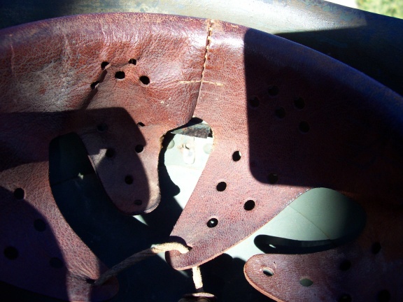

Ciao Arditi! Per curiosità* riesci a vedere se nella parte rovescia dell'imbottitura è presente un timbro o un marchio di fabbrica del produttore?

Gentlemen,[:)]
I was hoping we could take a closer look at this helmet again? I looked closely at a Spanish example I have in my collection and reviewed Piesse's RSI charcoal-grey elmetto in his earlier thread. I think my helmet is much like his and not like the 3-4 Spanish examples I have seen over time. Not very many examples on my part I know.[8)] I hope you will be patient with me gentlemen.
Take this into account:
(1) My example has a charcoal-grey primer over the earlier Italian
finishes. The Spaish examples appear more greenish-brownish.
(2) My example has 2-3 differing colored browns and greens under
the lip of the helmet.
(3) It appears the 2-3 differing colored camo colors have been
wiped off the outer portion of the helmet.
(4) I have heard that some of the Italian camo that was used was a
water based/thin camo that washed off easily? True?
(5) The brown/greenish camo on the Spanish examples all appear the
be cracking and very thick. The finish on my helmet is very
thin and not cracking...and very uniform in texture.
Please forgive my playing "Devils Advocate" gentlemen, but I hope you will give the helmet another look please. Perhaps more photos? Thank you for your patience with me.
In Friendly Scholarship, Arditi[:)]

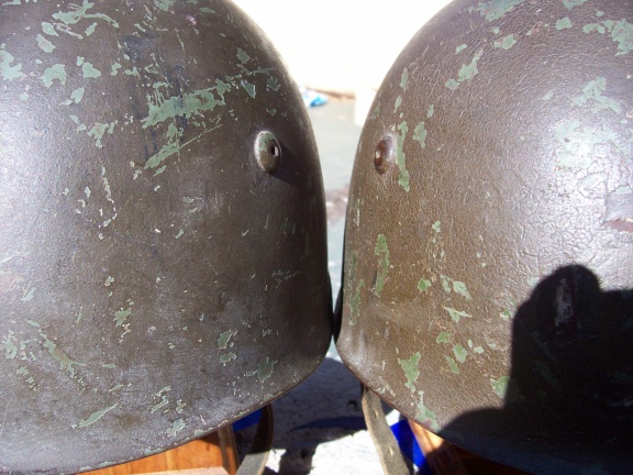

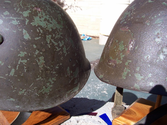

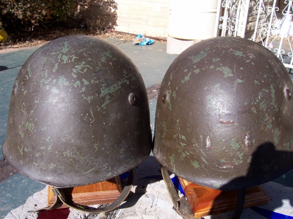

Ciao Ragazzi,[:)]
I took some comparison pictures of the helmet in question and a known Spanish helmet. Notice the thicker camo on the right example and how thin the camo is on the left example. Most of the examples I have seen of Spaish helmets appear to look like the helmet on the right. The camo is thicker, more greenish-brown in color and the finish appears to be cracking in the examples I have seen. I have only held 3-4 of these helmets. Not very many to make a full educated guess on differing helmet finishes. The helmet on the left appears more charcoal-grey to me. I don't know gentlemen. Any further opinion and/or thought appreciated. I thank you all for your patience with me.
Ciao Ragazzi, [:)]
Ho preso alcune immagini di confronto del casco in questione e un casco spagnolo conosciuto. Noti che il camo più spesso sul giusto esempio e come assottiglisi il camo è sull'esempio di sinistra. La maggior parte degli esempi che ho visto dei caschi di Spaish sembrano assomigliare al casco a destra. Il camo è più spesso, verdastro-più marrone a colori ed il rivestimento sembra spezzarsi negli esempi che ho visto. Ho tenuto soltanto 3-4 di questi caschi. Non molti per fare una congettura istruita completa sul casco differente rifiniscono. Il casco a sinistra sembra carbone di legna-più grigio a me. Non conosco i signori. Nuova opinione e/o pensiero apprezzati. Li ringrazio tutti per la vostra pazienza con me.
Nella Borsa Amichevole, Arditi[:)]

Anche se la vernice non e' identica, la tipologia è la stessa;La differenza dei colori dipende essenzialmente dall'ossidazione subita nel tempo:mi piacerebbe dirti che il tuo elmetto è della RSI, ma obbiettivamente è un bell'elmetto M.33 del periodo della guerra civile
spagnola (ne abbiamo a decine di esempi, nel nostro database.)
Even if the paint is not identical, the typology is the same in both the helmets compared:the difference on the colours depends basically by the oxydation;I'd like to say you that helmet were of the RSI, but practically it is a nice M.33
of the SCW period (we've several examples on our data base).
[ciao2]PaoloM
Thank you for the extra explanation and patience with me Paolo.[:)] I have learned something new from your help.
Many Thanks! In Friendly scholarship, Arditi
Grazie per la spiegazione e la pazienza supplementari con me Paolo.[:)]
Ho imparato qualche cosa di nuovo dal vostro aiuto. Molti Ringraziamenti!
Nella borsa amichevole, Arditi
