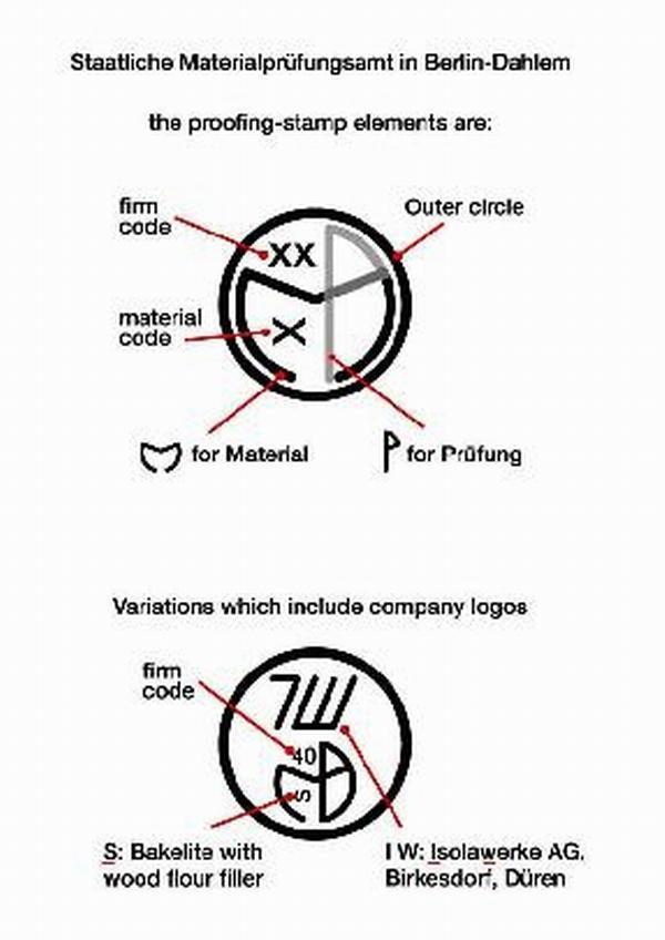

    ciao a tutti da un po non mi faccio sentire , posto ora alcune informazioni interessanti sui marchi in questione che a me sono risultate molto utili
    ciao a tutti
    List of Press Work Codes of the Materialprüfungsamt as of December 1938:

    In addition to the maker codes listed above and on the previous pages there at least another 100 further makers which we have, as yet to identify.
    Below we list the chemical composition types of bakelite items. This is the letter or number that appears in the lower part of the Materialprüfungsamt logo. In the case of the example shown here you can see that it is an "S", denoting that the bakelite comprises of a wood flour (sawdust) filler.
    Type1
    Carbolic Resin (Bakelite) with inorganic (mineral based) filler.
    Type 2
    Synthetic material with Asbestos or alternatively an organic filler.
    Type 3
    Kunstharz with Asbestos or alternatively an organic filler.
    Type 4
    Bitumen with Asbestos or alternatively an organic filler.
    Type 6
    Natural resin or Bitumen with an inorganic filler.
    Type 7
    Type 8
    Type A
    A Cellulose mixture with some other sort of filler.
    Type K
    Believed to be a urine based compound with an organic filler.
    Type M
    Carbolic Resin (Bakelite) with an inorganic (mineral based) filler, possibly asbestos?
    Type O
    Carbolic Resin (Bakelite) with wood dust/sawdust (wood flour) filler.
    Type S
    Carbolic Resin (Bakelit) with wood dust/sawdust (wood flour) filler.
    Type T
    Carbolic Resin (Bakelite) with a textile based filler.
    Type X
    A silica cement compound with Asbestos or alternatively an organic filler.
    Type Y
    A Lead and ash filler.
    Type Z
    Carbolic Resin (Bakelite) with a woodpulp filler.

    Ottima integrazione Alessio,proprio quello che ci voleva.
    Ciao Alessio ottimo lavoro molto interessante.
    Questo vuol dire che esiste qualche pubblicazione che tratta l'argomento non lo sapevo.
    E pensare che non ho mai dato grande importanza a questi marchi alla ricerca sempre dei Waffenamt.

    Grazie Alessio, finalmente sò cosa significano quei marchi!
